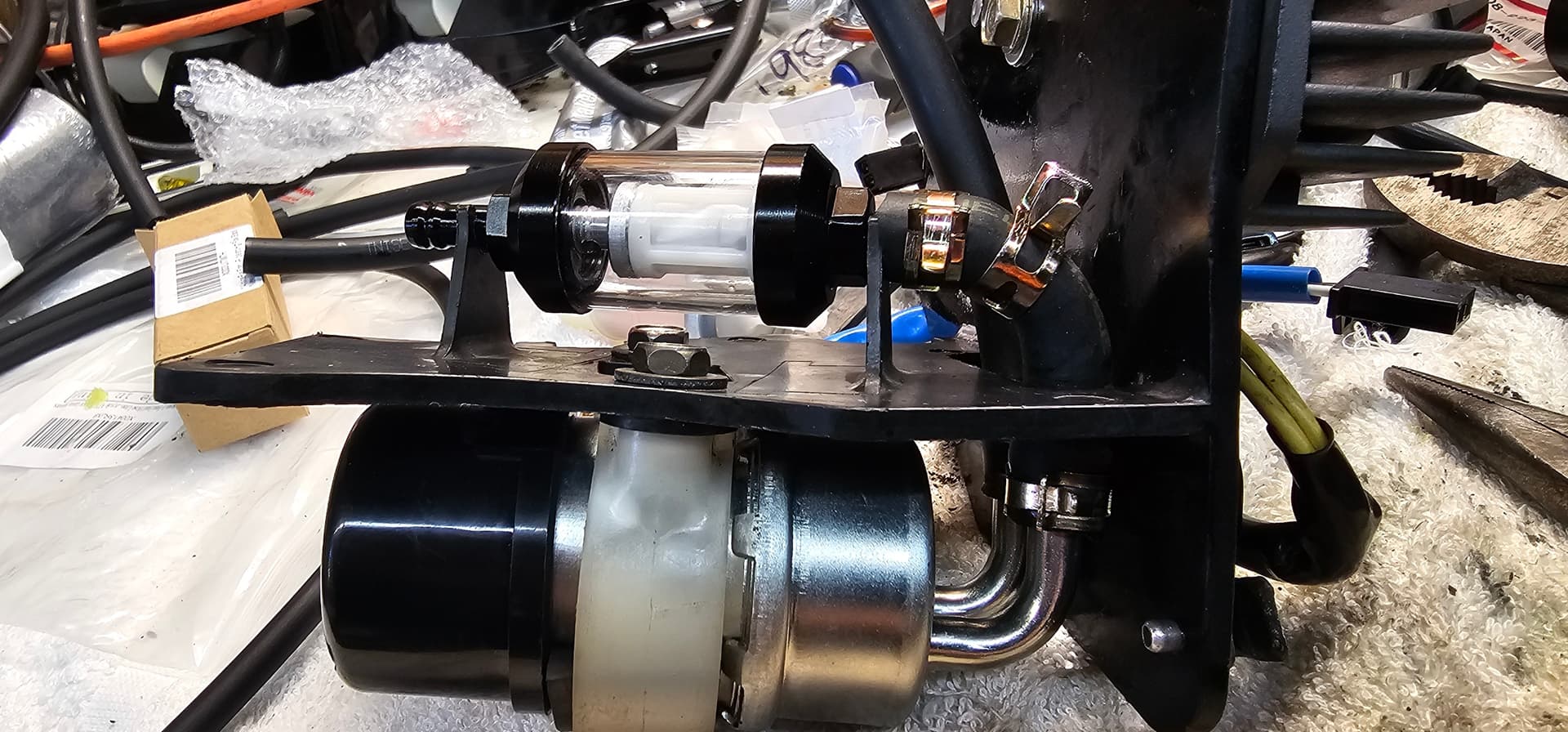

My 1984 US VF1000F needed a new fuel pump and filter. Stock fuel pumps aren’t available, obviously, so I looked to see what would take its place. I wanted a new filter too and uses stock wiring.
I started by first purchasing a fuel pump that fit in well (I just had to put a rubber spacer so the white clamp that holds the fuel pump in would hold it in tight:
This is a new fuel pump by Bomba (16700-MB6-631) and the ebay title was “1985 Honda VF1000 Interceptor Fuel Pump repl. 16700-MB6-631,16700MB6631 Bomba”. The picture is not what I received. The ebay seller is: electricfuelpumpfactory3457
It was eBay item number 393682256707 when I purchased it.
And this fuel filter fits perfectly, and can be cleaned and is visible: https://www.amazon.com/gp/product/B0C77DNKJG
And for good measure, I got a new Fuel Relay (36100-MB1-701) from amazon (plugs in perfectly) https://www.amazon.com/dp/B0B19NZYHG
I also bought thick, high quality fuel line. It takes a sharp bend, but you can see that with a strong fuel clamp positioned at the bend, the hose will not easily kink. I tested about 3 different kinds of fuel hose that I had in the shop to get the bend not to kink and starve the pump for fuel.
Here is the finished result:

You bet! I’d get this fuel pump. The one I listed stopped working. May have been a fluke from the pump.
