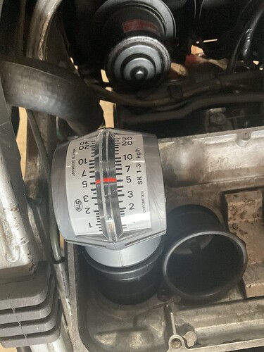

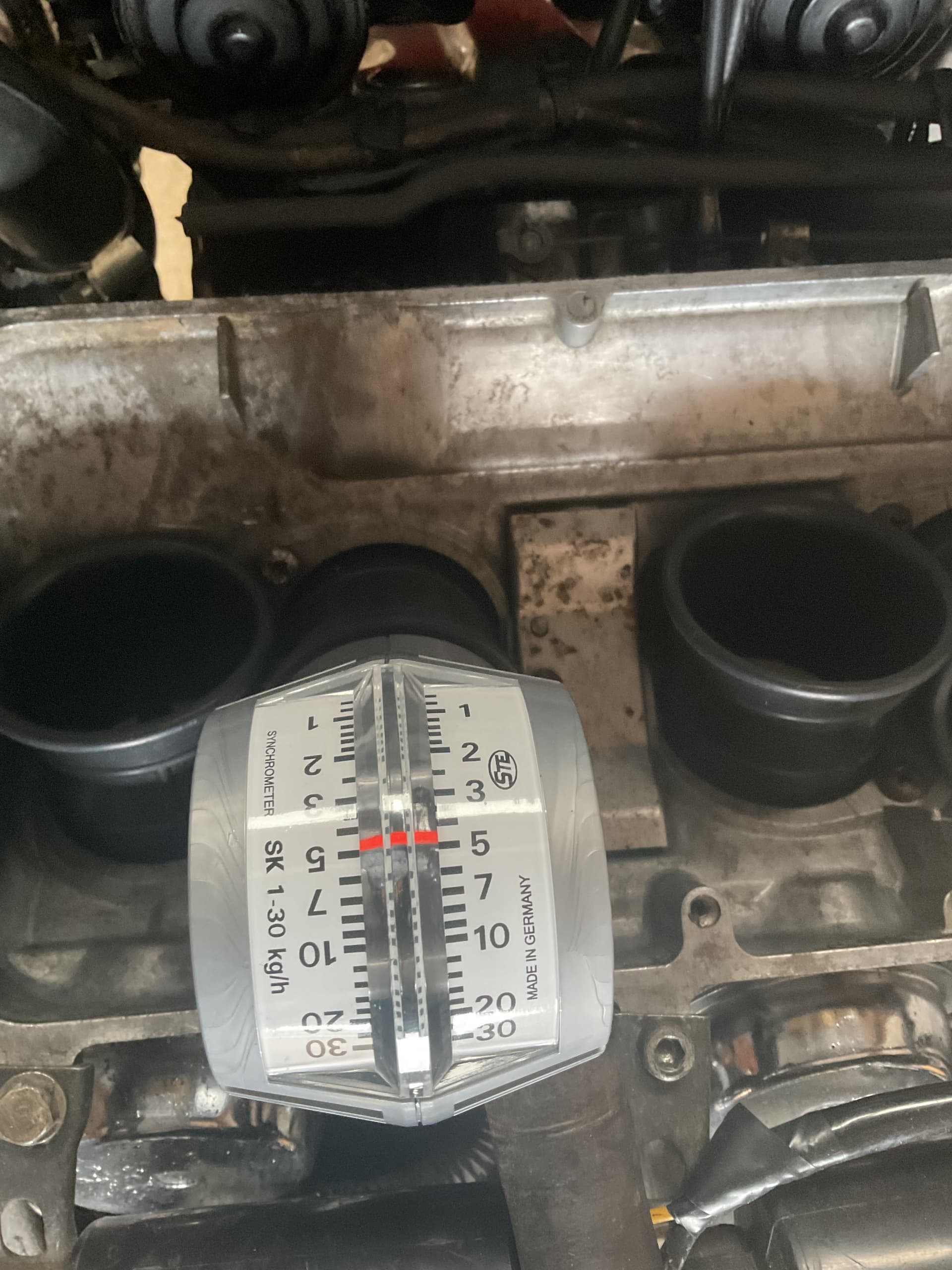

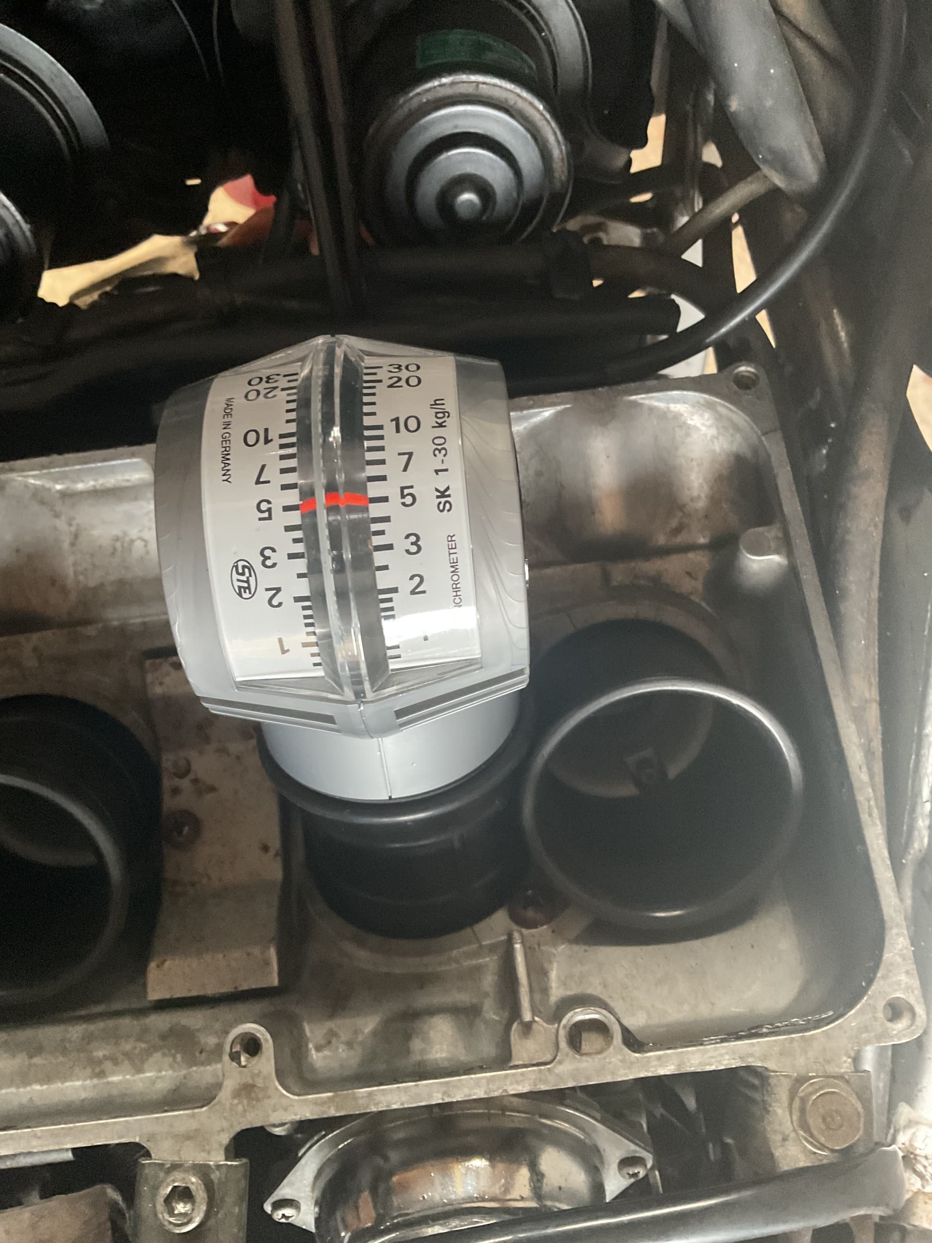

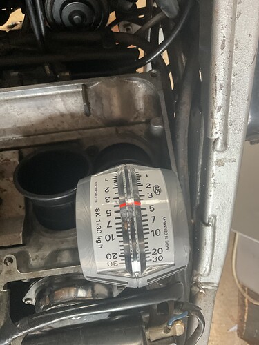

Hello I’m trying to balance my carbs with this gadget I purchased.. as you can see the first 3 ports are near on ok but the 4th is out… anybody know which adjustment screw will alter this… I’m a bit lost. Thankyou

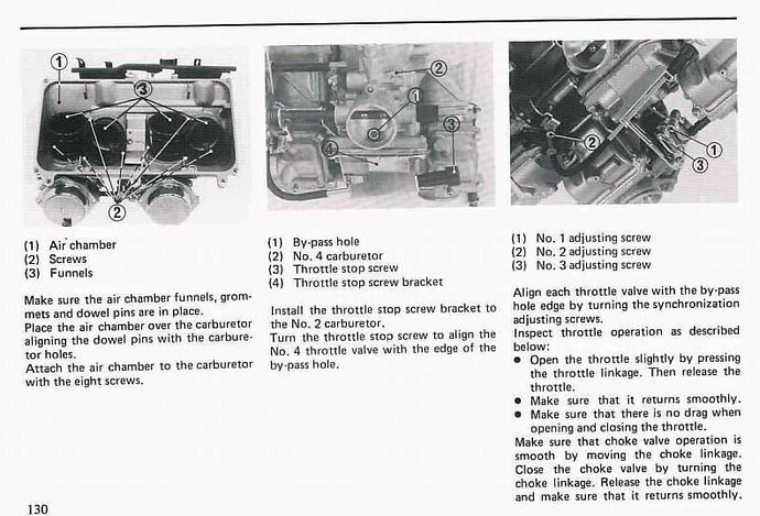

#4 cyl is the master…all the others are adjusted to match it. There’s a procedure in the manual for it. You’ll need a proper adjusting tool to do it on the bike…impossible to get at them easily with normal tools.
Here’s a pic out of the manual.
