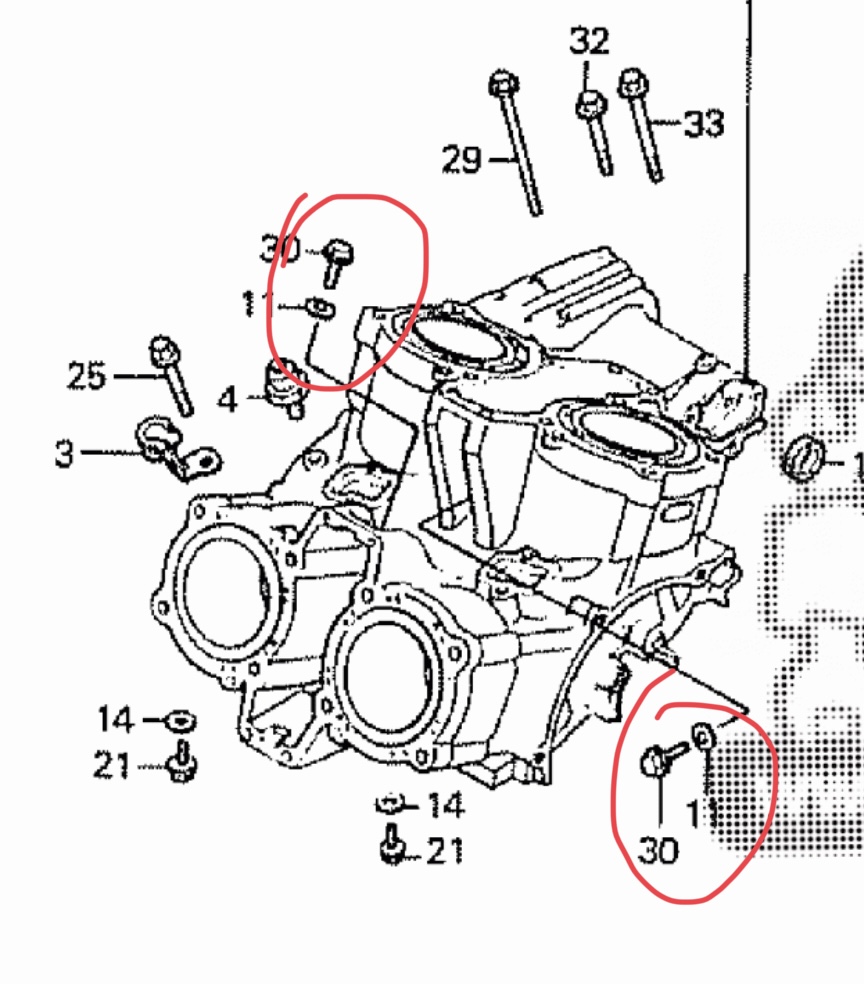

The main thing stopping you converting an F an R is that the F cylinder block doesn’t have a machined boss the accept the gear train mounting bolt #30.

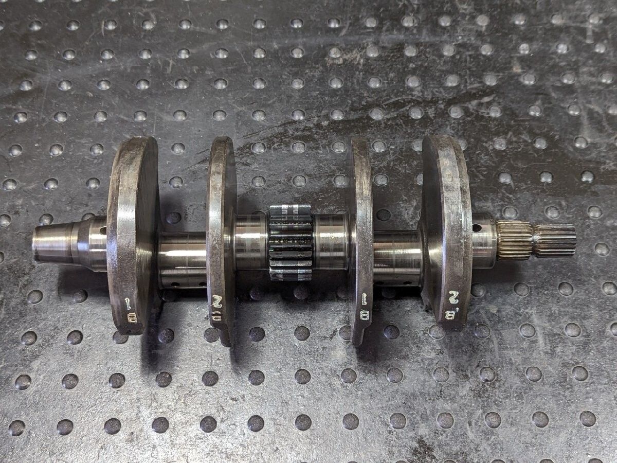

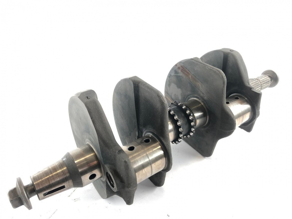

Unfortunately not…the crankshafts are different too…the F has a pair of sprockets in the centre for the chains, the R just has a wider single gear in the middle for the cam gear drive mechanism… And as DonR shows, there is a pair of bolts in the “V” of the engine which hold the cam drive geartrain which the F doesn’t have.

F crank here:
R crank here:

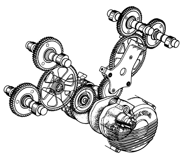

Gear drive illustration:
Ahh, with the gear drive out of the question it probably wouldn’t be worth messing with anyway. Are the heads any different? Do they flow any better than F heads, and could you put F cams in them, or use F sprockets on the R cams? But again, probably not worth it for a few extra horsepower anyway even if it were the case.

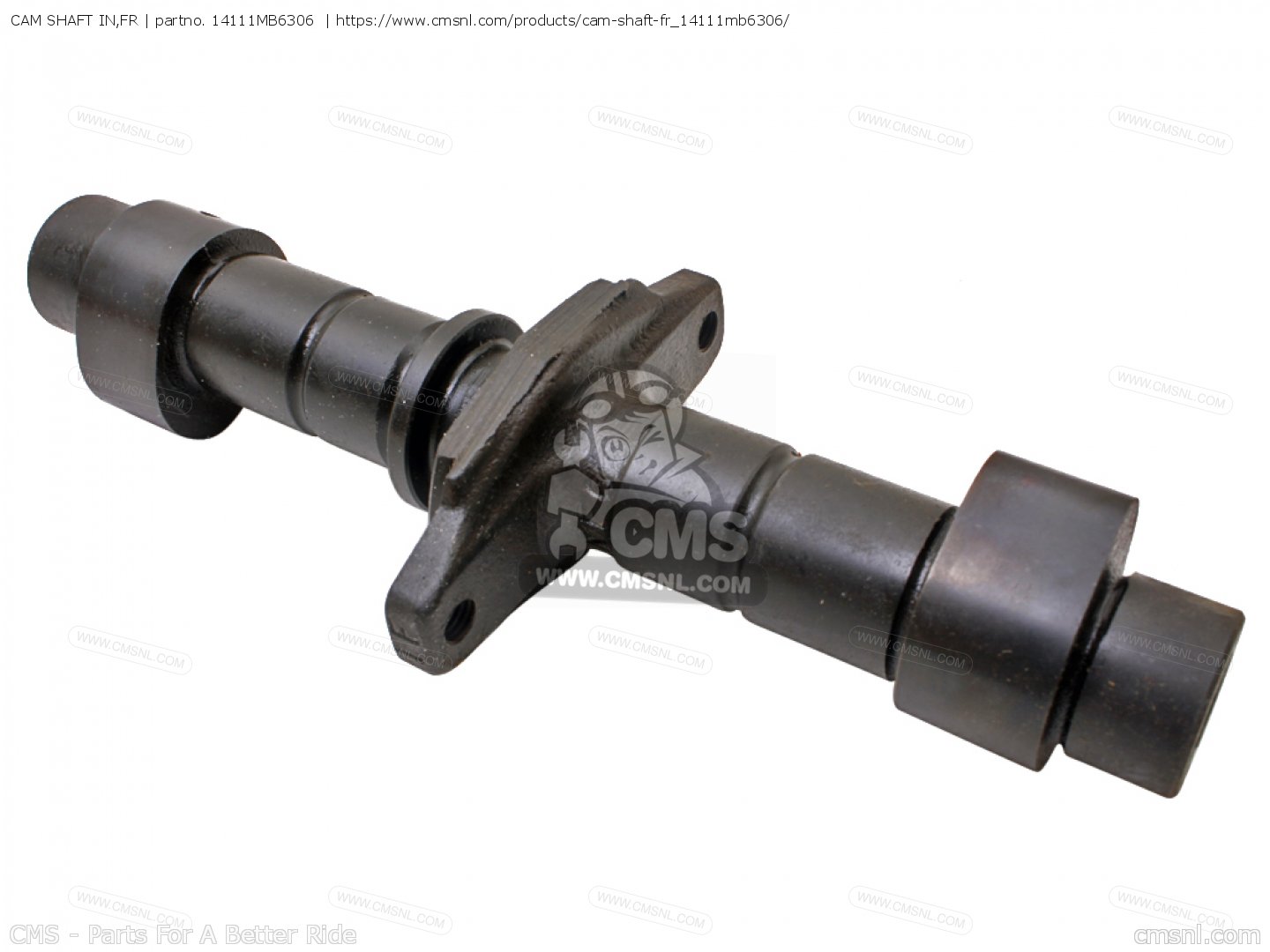

Heads themselves are essentially the same. No, you can’t put F sprockets on the R cams, nothing to bolt them to. F cams have a twin bolt setup, the R cams are totally different.

F camshaft:
