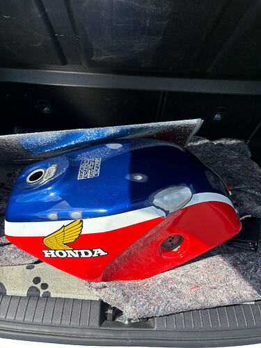

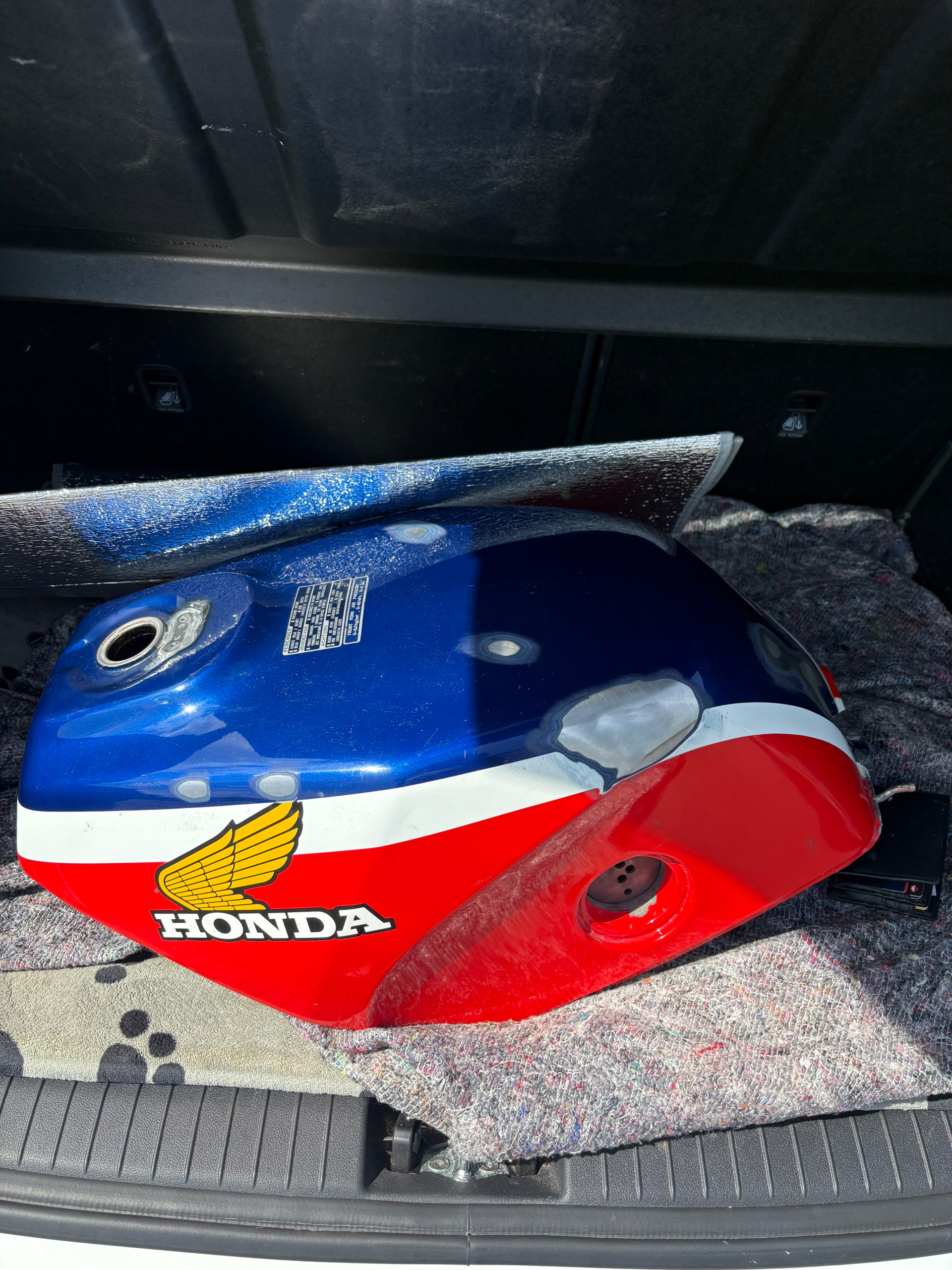

Hi, I’ve have the same issue with my tank.. it had a old liner in there that had all fell away and a lot of the tank inside was full of rust… I took it to a fantastic guy who’s a tank specialist in Yorkshire… I had the liner removed, all the rust removed and seemed clean… I had a drain hole put on the bottom of the tank with a stainless steel bung fitted.. then the tank had 25 µm of nickel plate on the inside… I had loads of pinholes which are now all repaired with silver solder… it’s at the paint shop now being sprayed. I’ll send some pictures of the bung and the inside when I get it back the bloke did a fantastic job but he did say it was one of the worst tanks he’s ever had to repair….
