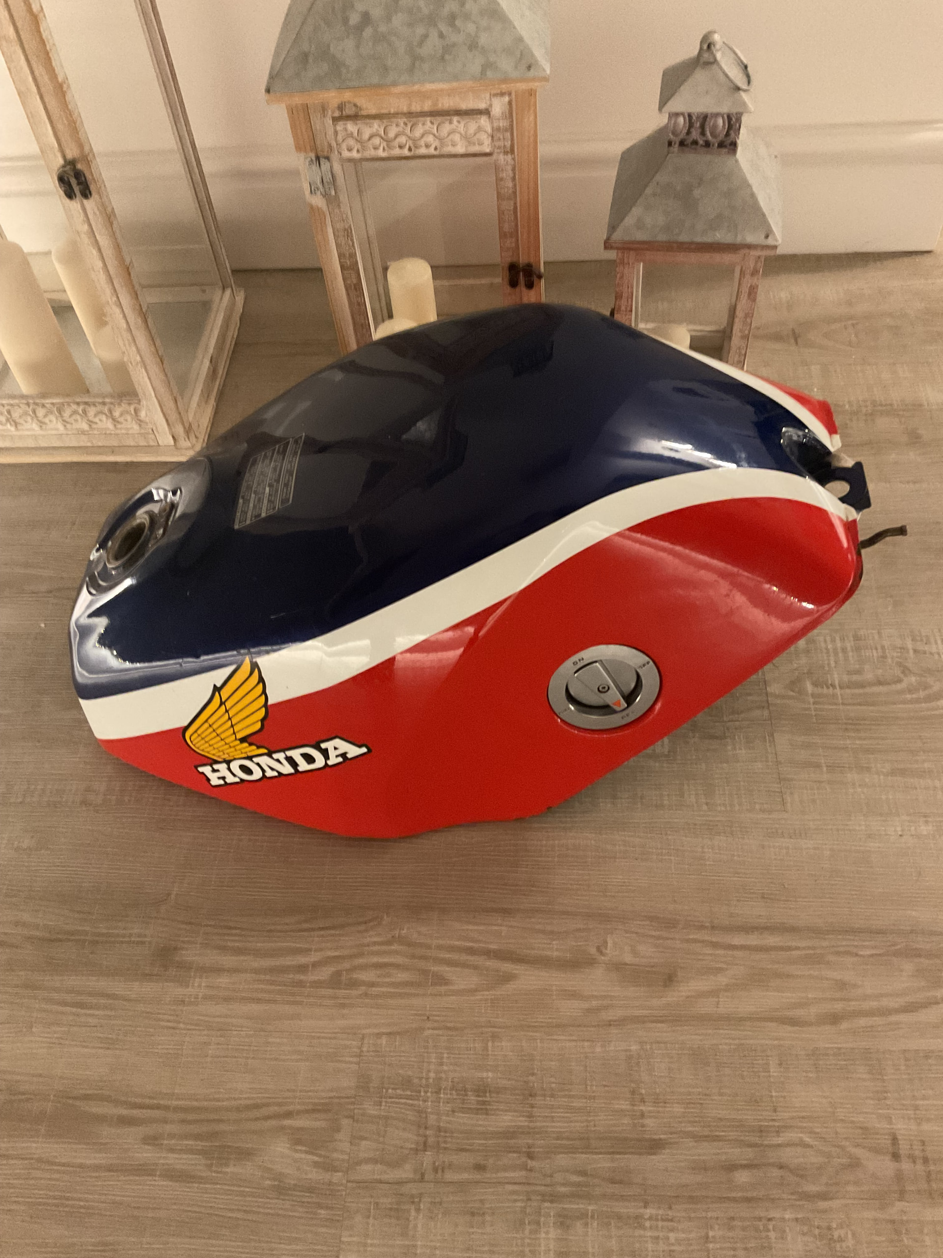

Hello all… need some advice please… I have been working on my 1984 VF1000r for over a year now and I’m nearly there on completing it… the last thing I need to do is sort out a rusty fuel tank which I thought wouldn’t be an issue.. so I thought! I have spoken to a tank restoration guy tonight and he said it is near on impossible to apply a liner to the inside of the tank after it’s been acid cleaned because of the valve inside the tank will get blocked during the lining process… has anyone got involved in tank cleaning on this bike and know about this issue… the guy talked about cutting the bottom out of the tank, re-piping and blocking of the main on/off fuel tap and putting an external fuel stop cock on which I’m not the keen on doing.. any suggestions would be mostly appreciated. Thank you Sean

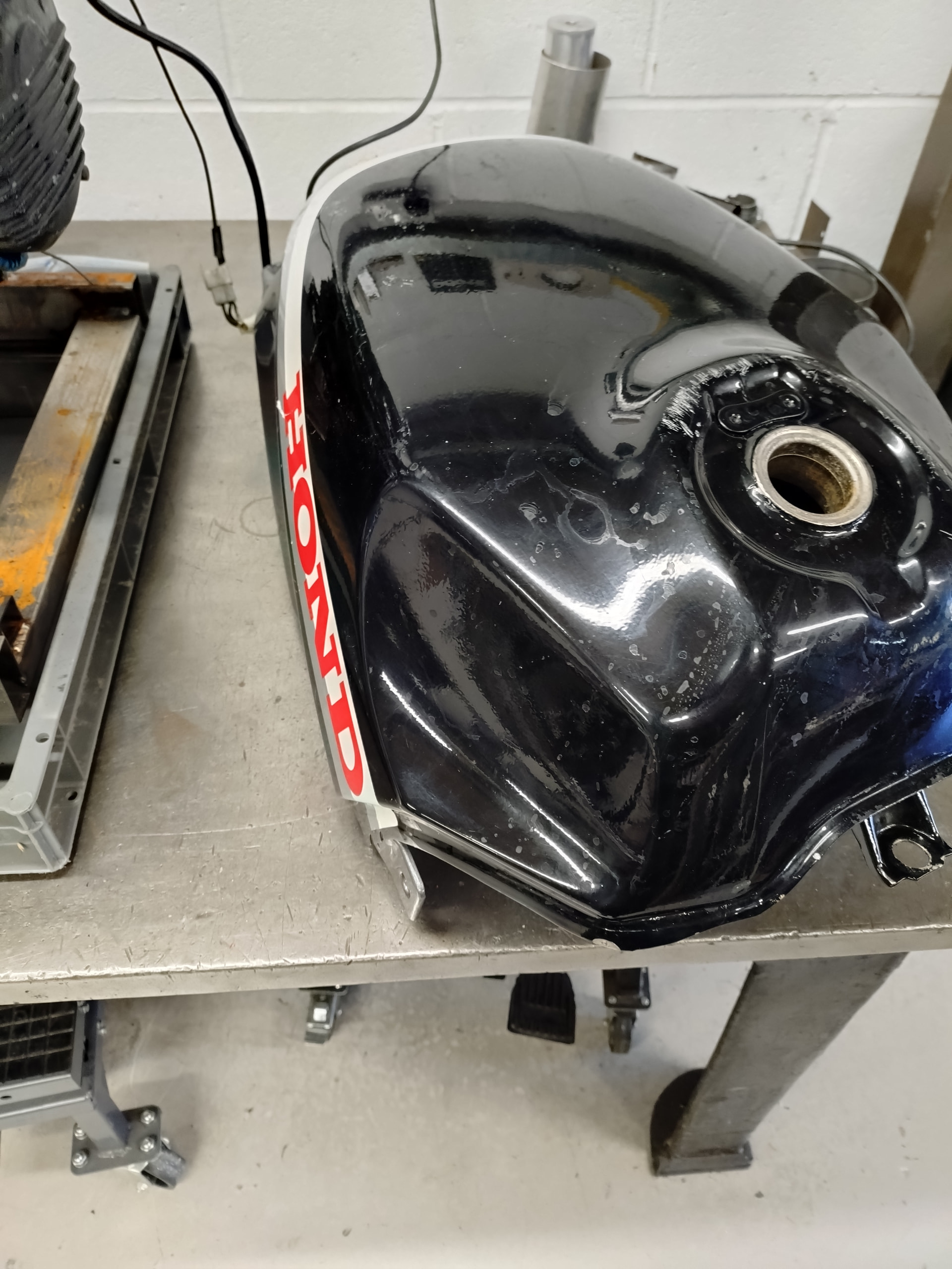

I’m working on the first of my R tanks now. The one I picked I thought was the easiest to fix. A couple of things have complicated the fix. Firstly, a few blemishes in the paint along the bottom seams turned out to be bigger rust holes. Secondly, the tank had been lined.
Before i could go further I had to make the tank hold liquid. I sealed it with JB weld and cut and welded a drain bung in the bottom to aid draining.
Used 5 litres of acetone agitated with nuts and bolts ti strip the liner. Washed the acetone out with petrol, and dried out.

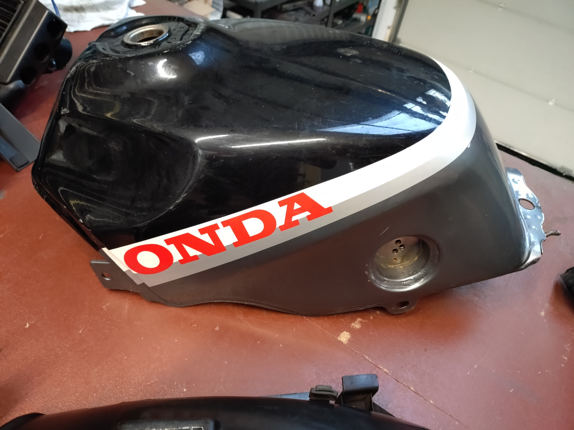

Pictures below are the VF tank after I’d had it plated, the plating only sticks to bare metal & total cost was £70 :

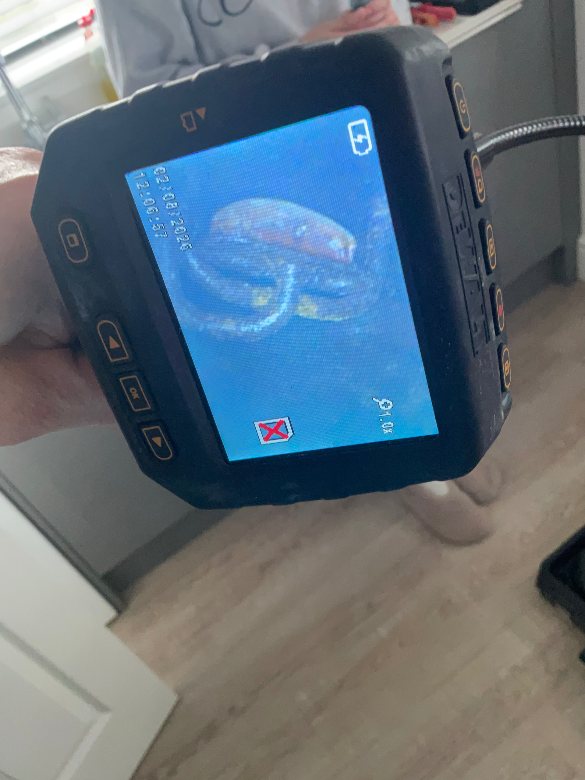

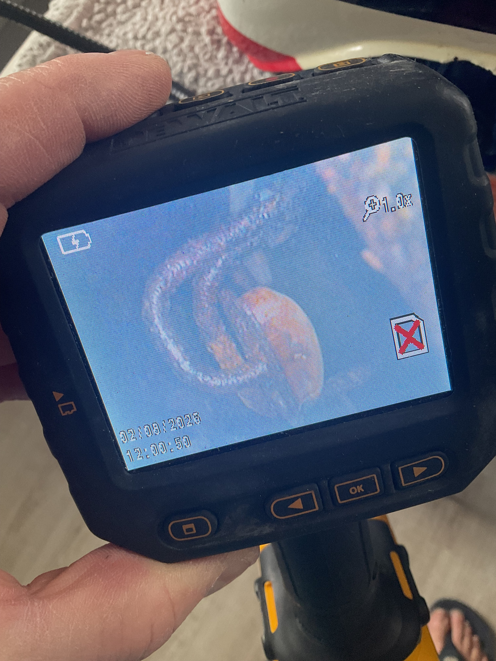

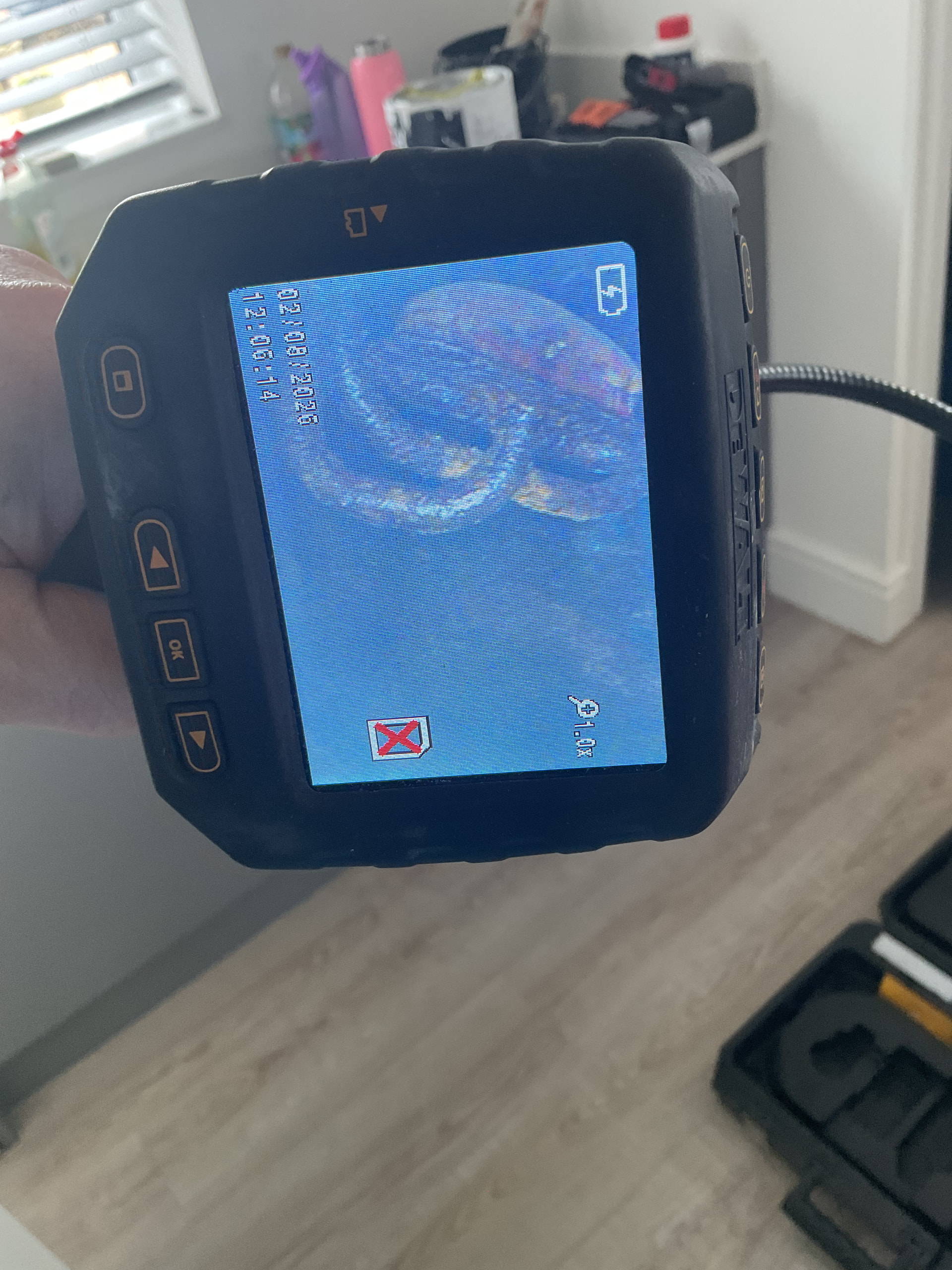

This is the inside of my tank.. I can see the plumbing and the mesh and can see why you have to be careful when applying a liner

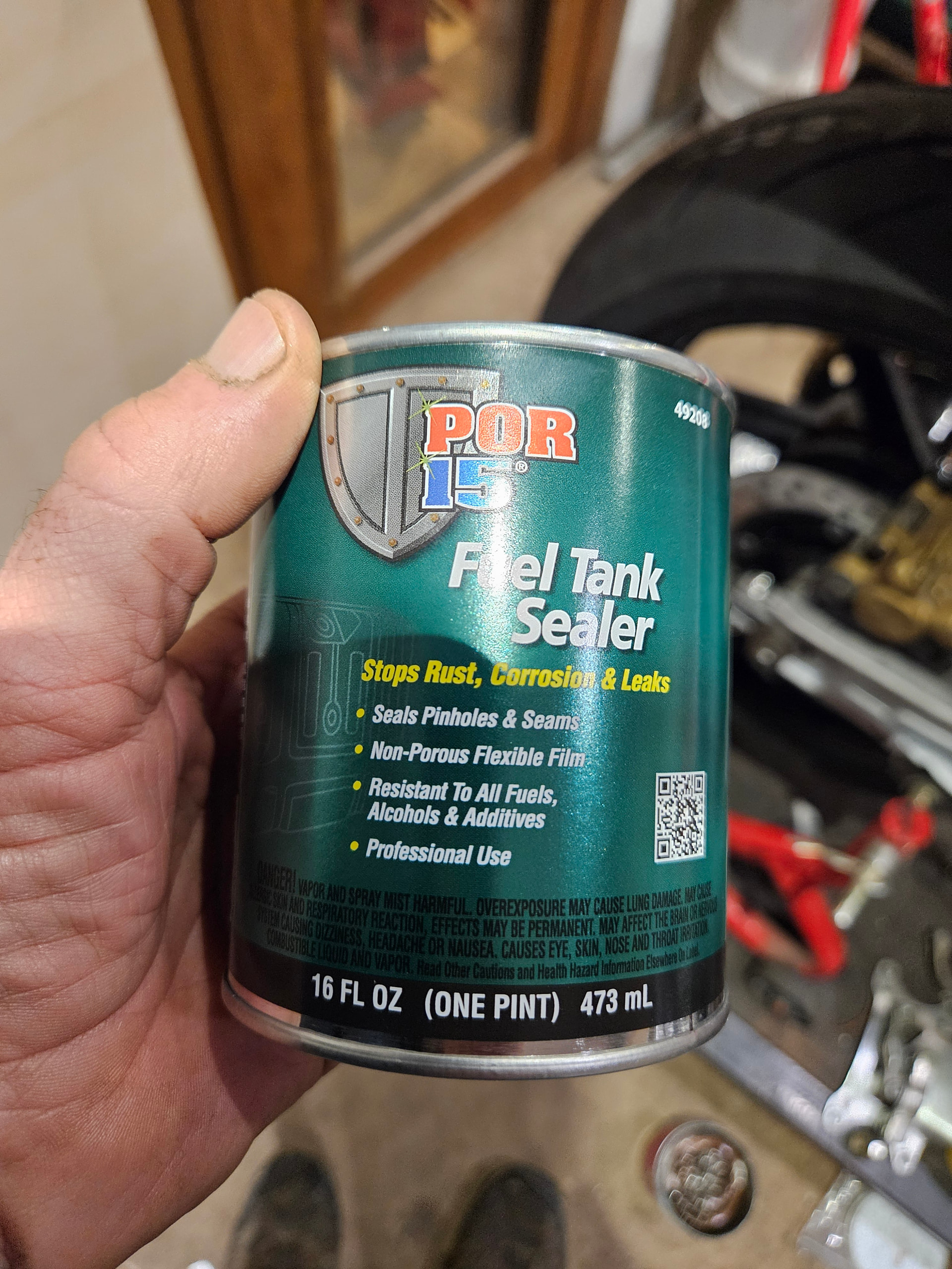

My mistake, It’s the 473ml por15 that I use not the 235ml

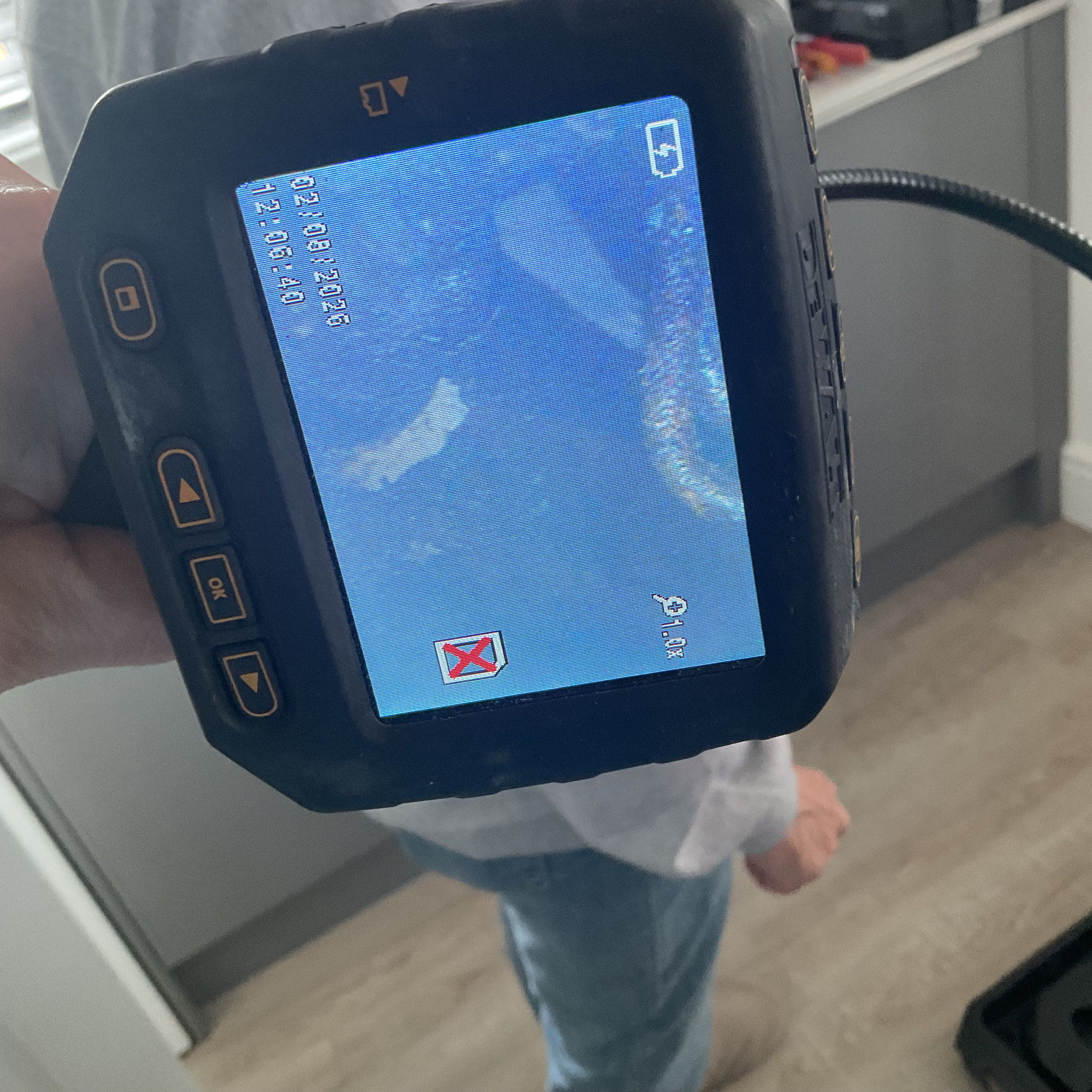

ich hatte auch dieses Problem. Wie bereits erwähnt, sind die Siebe ein Problem, aber ich habe es gelöst, indem ich nur so viel Dichtungsmittel in den Tank gegossen habe, dass die Siebe nicht verstopft wurden. Und ich habe das Material erst ganz zum Schluss an diese Stelle fließen lassen. Es ist ratsam, den Tank mit einer Inspektionskamera zu überprüfen. Anschließend habe ich die Siebe noch mit Luft durchgeblasen, um sicherzugehen, dass sie durchlässig sind.
