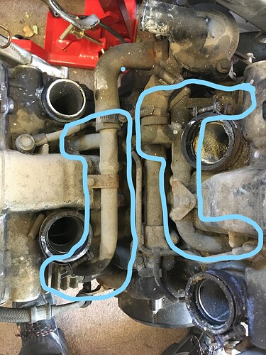

Hi VF fan’s,
Can someone please tell me how these pipes ( marked ) are removed
I’ve taken the brackets off that lock them in, and to one on the rear head moves but won’t come out, the front head no movement at all

They are a push fit into the head on two Orings,plenty penetrating fluid and wiggle.
A gentle tap with a soft face mallet to get them moving won’t hurt
