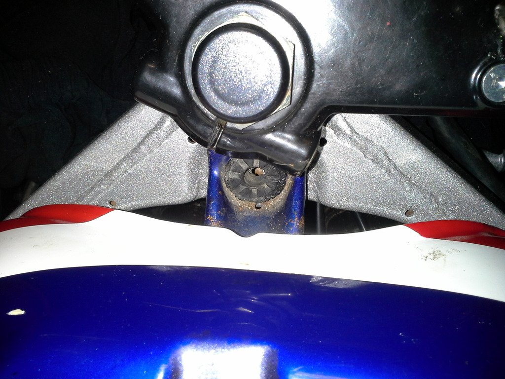

for some reason it has cut off the sides of the inverted petrol tank picture, i’m in work at the moment but will take some more pics tomorrow. the only thing i could think of is that the front mounting point has been bent up and forward as the rear can’t go anywhere.

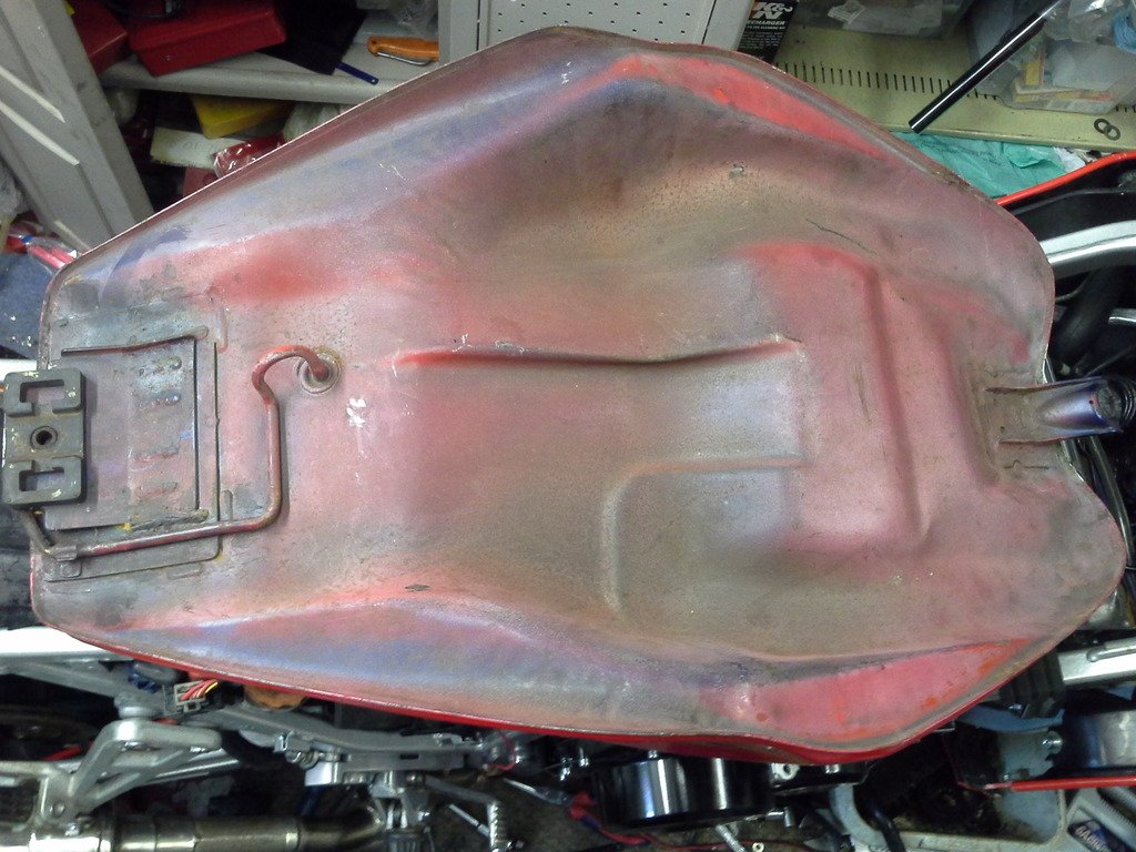

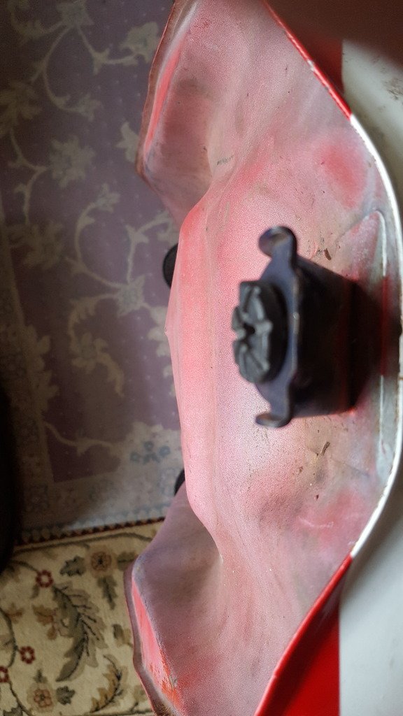

underneath of tank

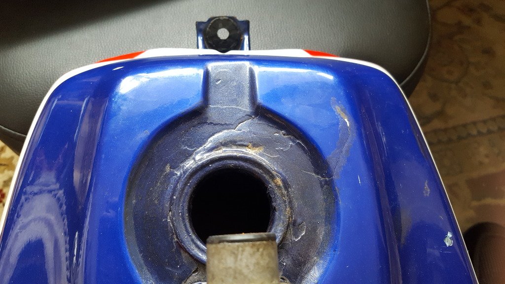

front mounting including rubber about 10mm past mounting hole.

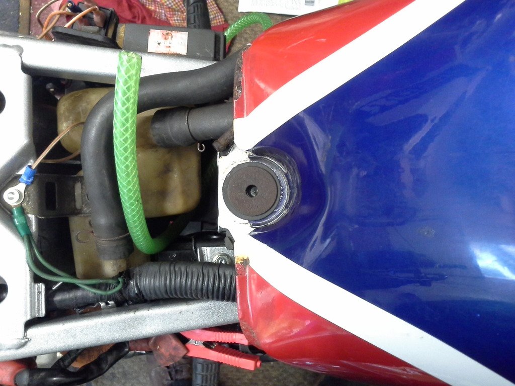

rear mounting point with rubber. will take a picture of how tank sits if coils and airbox fitted later.

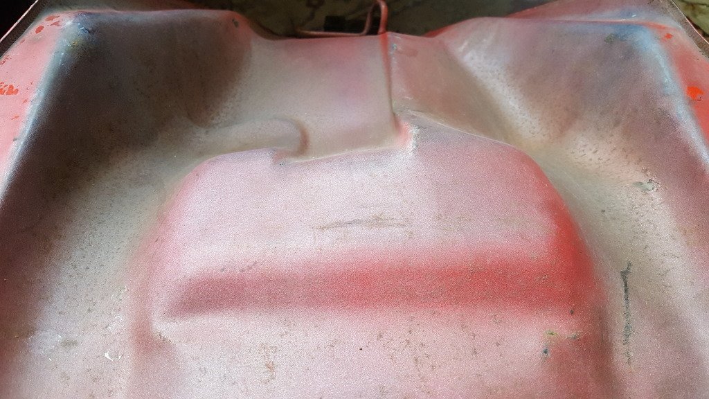

ok on closer inspection it seems to be the tank, though have no idea how you could cause this damage.
the mounting point does not look to be central.
the centre of the tank bulges, it is this that is hitting the airbox and coils.
i presume that the centre is supposed to be flat, the only thing i can think of is that somebody has tried to blow dents out using compressed air and inflated the tank like a balloon! a shame as from the top it looks in reasonable condition for its age.

seen this one on german ebay, i think its too much money for the condition but theres a nice pic of the underside of the tank which may give you an idea as to how yours should look
[ebay]162431075515[/ebay]
Thanks pete, as I suspected the raised piece going across the tank should be level and not going to a point like mine. Will try knocking it flat and see if that helps but making it shorter could bemore difficult. The price for that one is too high but the ones on uk ebay are in worse condition and not much cheaper. If its for a vf1000 r the price seems to double! Will look on japanese auction site jauce but delivery is very expensive.
