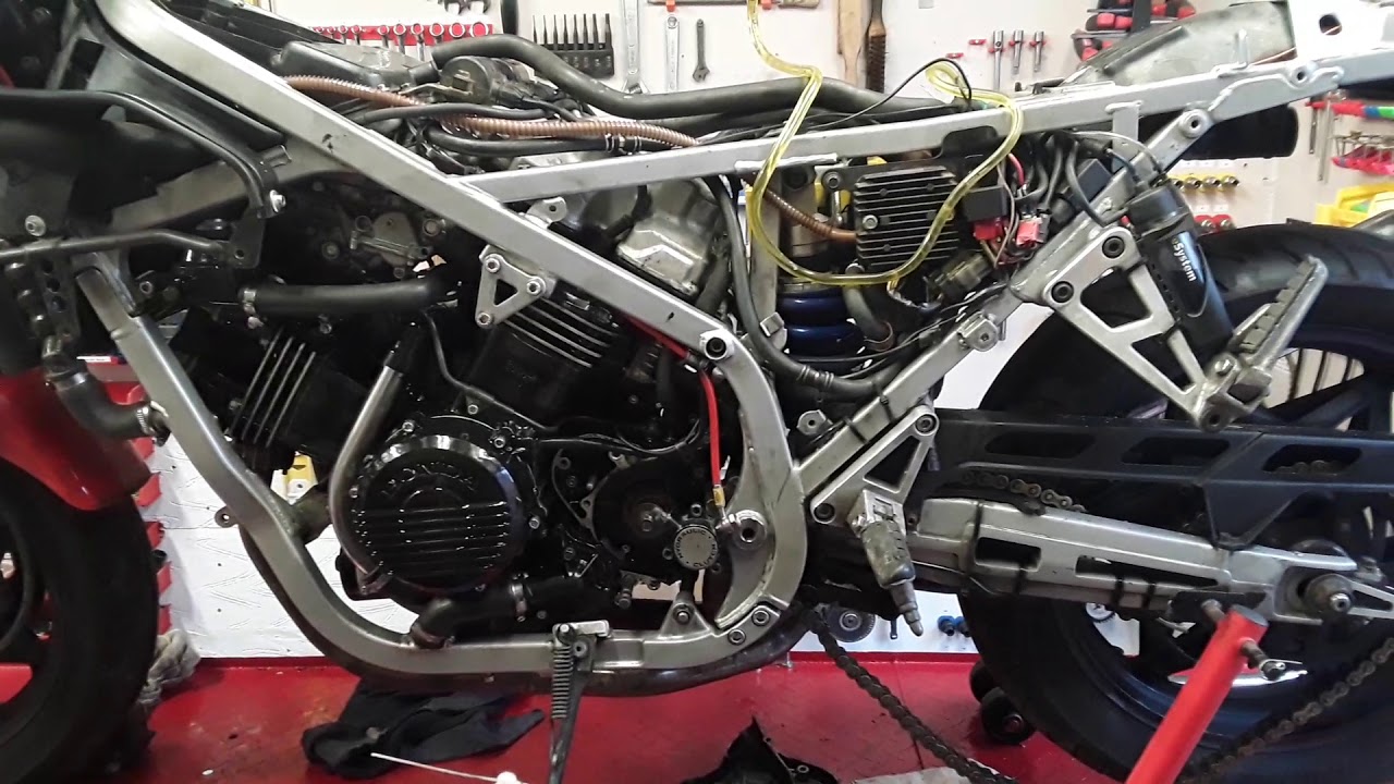

Engine back in frame just the clutch and starter gears to fit and coolant to do so not long now.

Looking good gary :+1:
