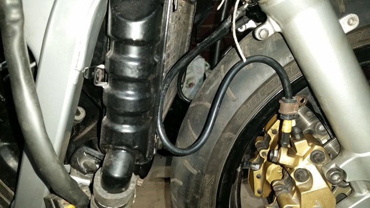

Forks fully compressed, leaves about 25mm clearence between tyre and radiator, the mudguard just rests against the radiator when fitted but that will be too close when the forks flex under braking so will have to sort something for that

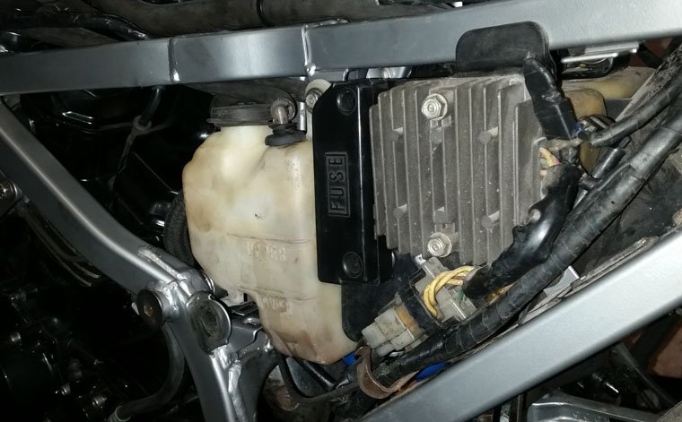

CBR600F fuse box, extended the original lead, just fits in between the FE coolant bottle and the FF regulator.

Looks good Pete,the CBR fusebox is a particularly neat touch.

one day i will have a plan and stick to it… ive now decided i cant live with the bar riser set up and need to get back to clip on’s… so ive had a set of vtr1000f fork tubes made up 60mm longer than standard, this will allow me to raise the front end a little so the front mudguard dosent touch the radiator, and refit the ff yokes and clip on’s.
Just got to put the final touches to the damper rods and needles which also need extending 60mm, spray the sliders and front mudguard and the jobs a good un…

the VTR1000 forks are all assembled and in using the new longer tubes, vf yokes and clip on’s. the original springs were way too soft so i opted for some K-Teck 1.1kg springs to compensate for the extra weight of the vf… My first thoughts on the front end is that its a little too hard and may need slightly less powerful springs but ill give it a few good runs before i change anything, The brakes are powerfull and progresive with loads of feel…the riding position feels slightly more forward due to the new forks being aproximatly 25mm shorter than the stock vf ones, but its not uncomfortable
