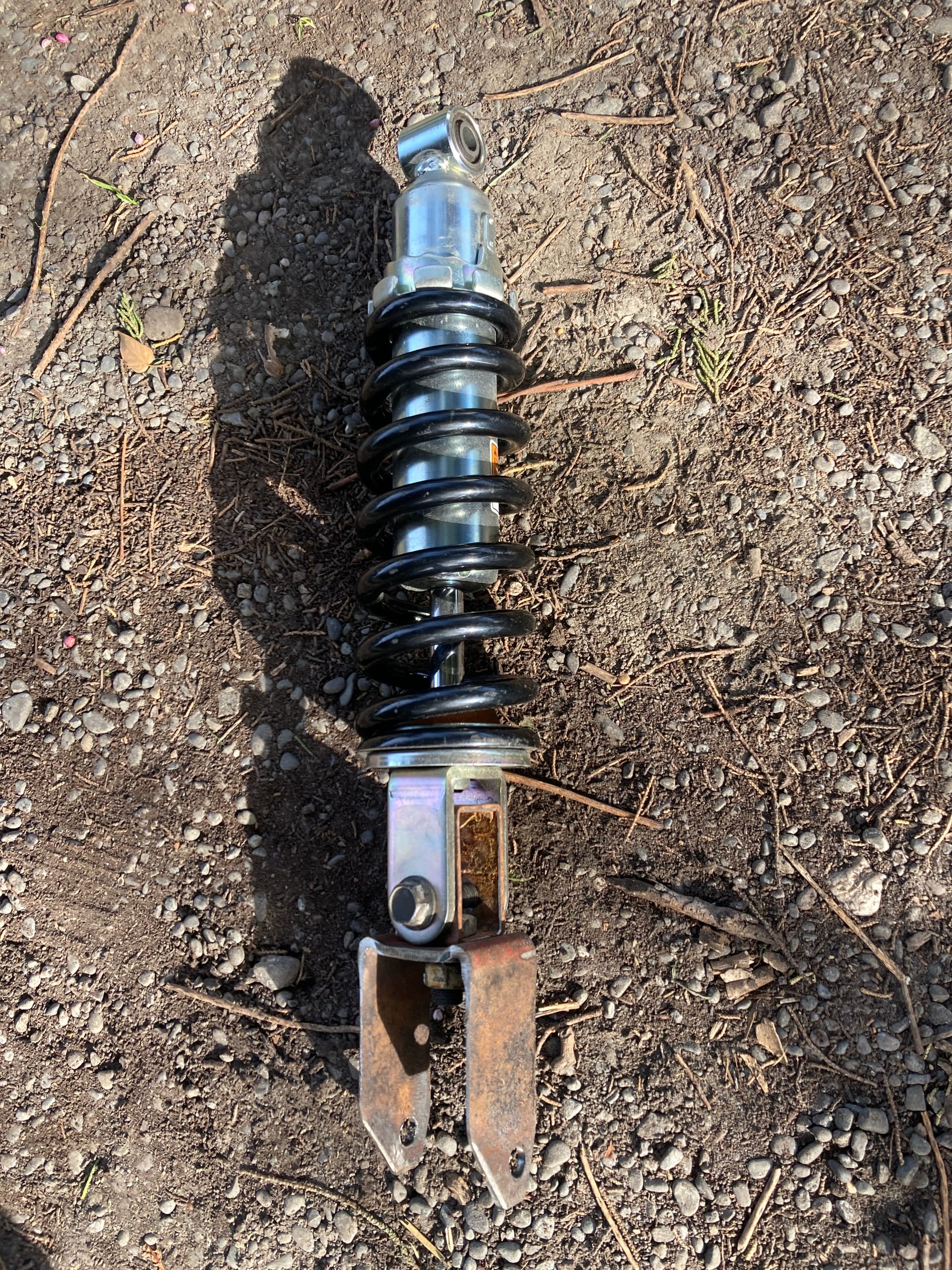

Ok I put a newish (lengthened) SV650 shock on it.. it’s a bit soft but hasn’t bottomed out yet and so much better than a hardtail. I’ll swap it out for the heavier gsx shock after I’ve got the forks sorted
I like how you’ve lengthened it. When yo do the Gxxr shock think about forming a flange on the top channel, or weld on a couple of tabs- to prevent it starting to work like a hinge?
Yes well spotted, was thinking of cutting another box section a bit longer and bending 4 flaps for that.. either that or drill another hole. I thought the spring looked a little thin on this shock but had to try as it’s only 2 years old, but it sags badly since it’s off a 200kg bike- the 25y old gsx is 245, so much closer.. also might incorporate a thread in mk2 bracket to maximise height- I’ll do an update when I get there again.. cheers

I know it’s not the right shock infact I haven’t seen a similar long shock like this old VFs. I’m not sure of the SV setup- nr free and new drew me in, but the gsx is similar, except the hole through the swinging arm is wide enough to accept the whole shock. The links are slightly different and from what I’ve seen, the spring looks thinner

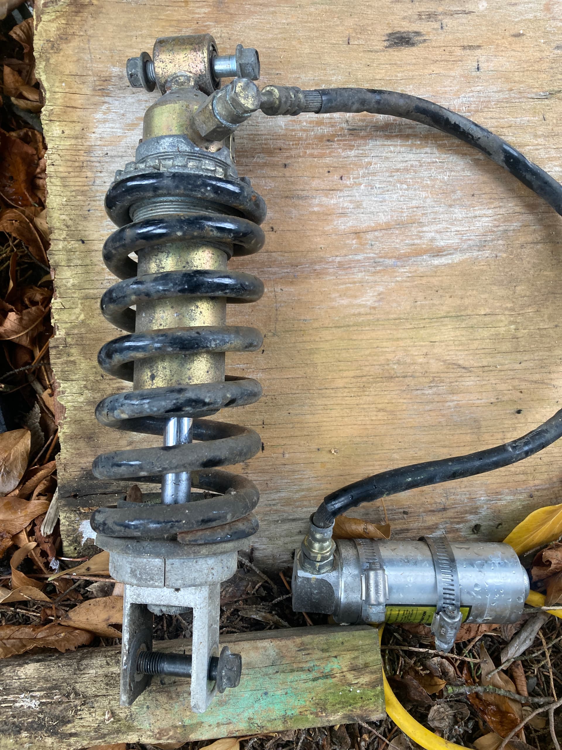

Well as it happened I had a spare few hrs and despite it being just 5 degs in my ‘open air’ workshop , I managed to swap them out! Unfortunately I felt a little pushed for time inbetween rain and hail showers so I did the (usual) minimum- which was just 2 new holes in Mk1 bracket to fit the gsx shock. (no pics sorry)
I tightened the spring to the max along with the dampner and there’s virtually no sag now- if anything I might have to back the spring off a bit- as jumping up and down tops it out. I won’t know until tomorrow, when I take it out for a spin. There’s also a small gas can on a hose with an adjustment screw I’ll have a play with. (and try’n find a spot for)
I’m still keen to do Mk2 as Mk1’s an absolute bodge! but if it works…? also I don’t think it’ll hinge as the bottom piece is solid and the top is too–- if it does though, I’ll be back for Mk2! -as it is the back tyre is about 1/2” off the ground on the centre stand. so probably as high as I’ll go

Here’s a pic of the gsx shock
